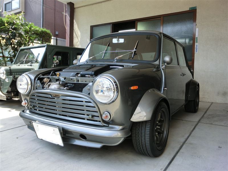

    The general view is that the Japanese like their Minis the retro the better but I just stumbled across this beastie
    http://minkara.carview.co.jp/en/user...8/profile.aspx
    A Mini with a 1.3 K3-VET Daihatsu YRV Turbo engine
    Power curve of the K3-VET against the K3-VE YRV engine and the K3-VE2 Sirion Engine

    Wow that makes my engine bay look spacious and it looks like this one has an extended front. Neat but full of engine. What HP and torque is that in English?

        About 138bhp and 130 lb/ft
        The bulkhead mod would be interesting as Daihatsus have flat bulkheads so there must be some serious mods behind the engine !

          And yes, it an auto !

            Although most of the pictures don't show it looks like a 50 - 60mm scuttle extension?
                Good spot, I hadn't noticed that

                  It looks beautifully constructed but I am using every trick in the book at the moment to try and keep my Vaux conversion under a standard length so am I very interested in any 'tricks' to hide them

                    Easy! Use a standard length clubman front!

                      It's plan 'B' but the extra room a Clubman front gives is just unbelievable having mocked one up in a moment of despair. I actually don't mind a Clubman front but still trying to keep it round nose and standard length.
