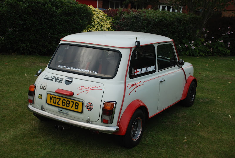

    The car is a 1988 mini designer 998cc, It has already been fairly stripped out with the usual bucket seats and harness's, fibreglass boot lid, poly carb windows.
    This is what the car look like around august this year, not much has changed, only the new boot lid and ive removed most of the stickers.
