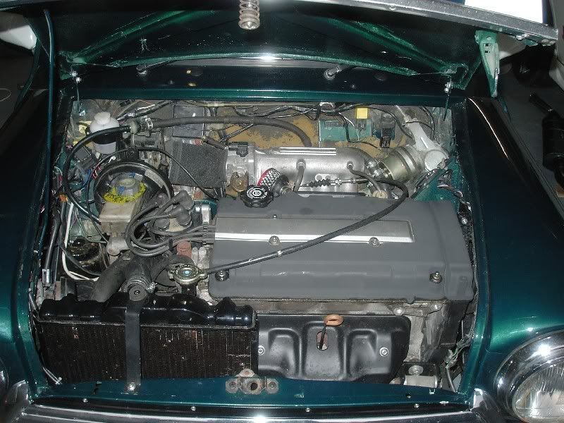

            • #66
              I fitted a LHD SPi throttle cable today using an Innovation D to B series throttle bracket, it was designed so that when transplanting a B series in to a D series Civic it allows the D series throttle cable to be used. I got it off ebay. The standard B series cable bracket is too far away from the spindle but the Innovation bracket moves things in to the right place. I tried a few different routes for looping the cable to the bulkhead but the best route I found was looped under the plenum to the bulkhead. The cable has a bit of resistance but its actually not unwelcome
              Watsons frame in a standard length front, they said it was impossible ...
              Build Thread - standard length round nose B series with Watsons frame, it is possible
              • #67
                Hmmm just as an update I ditched the LHD SPi cable as there was too much resistance and occasionally it'd momentarily stick the throttle open when you lifted off. I ended up speaking to Speedy Cables who made up a custom length throttle cable for me. I was panicking about making it too short and I think I over compensated slightly and it would have been ok 6 inches shorter but it loops nicely around the engine bay and gives the best pedal feel and control the car has ever had I just need to arrange some P-clips to support the cable around the engine.
                Just for info I based it on the SPi cable but only because I'd already swapped the throttle bracket to the Innovate one to fit the LHD SPi cable but if you were using the standard B series Honda bracketry you'd need to measure the inner and outer cable lengths as the adjuster end sits further away from the throttle linkage.

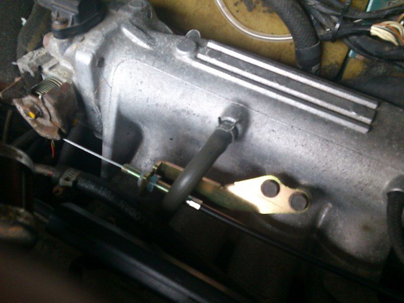

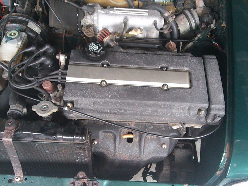

                      • #71
                        I just thought I post up a pic of my new throttle cable and bracket (not the most exciting pic, I know )
                        Compared to the cut and shut Honda cable that was fitted when conversion was done
                        This is the Innovate D to B series throttle bracket
