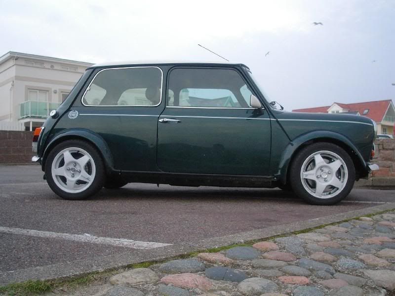

            New photos added to Gallery
            Compare this one to the side on shot in post above. Matt rebuilt front end as I wasn't happy with the way Geoff had done it. Much much happier
            Always promised I'd sort the interior and finally got to getting new seats, carpets and door cards
            I also dumped the bonnet stripes. The whole car needed a respray and Geoff had used longer stripes to suit the longer bonnet and I didn't have any to put back on but I actually prefer it without so I'm gonna keep it like that

                    this may help with the front end comparison....
                    awesome looking car, nice'n'sleeper
                    "Simplify, then add lightness"
                    It's street legal if it can outrun the cops...
                    • #11
                      Cheers .... why didn'I think of that
                      Yeah the wings were welded on at an angle so front pointed upward despite car having 1.5 inch forward rake - couldn't actually adjust headlights low enough to be legal Matt offered to have a look at it and as far as I'm concerned has made a 1st class job of it - I know he had some problems as the engine and rad sit quite high in the Wastsons frame so had to mod the underside of the bonnet for clearance. Can happily recommend 16vMiniShop for all your 16v Mini needs (no I'm not on commission )
