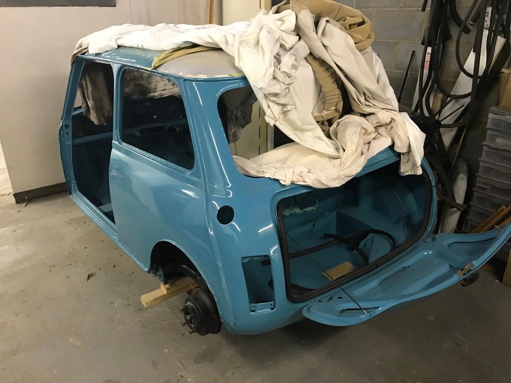

    So I purchased my shell off ebay back in Novemeber last year, work commitments have meant that I have only just managed to get round to making a start over the last week or, so I thought I will start off my build diary as a record.
    I brought it as an unfinished project of a guy that was going to do a Rover conversion but ran out of steam. Shell is 1987 and the guy I brought it from had replaced the front floors, sills and built up the back end. I was a bit dubious at first as I was not sure what was covered up by the respray, but as it was a good price I took the plunge as most of the car seemed solid.

    So with the shell now in my garage I got it up in the air and had a good look at the underside. Everything seemed good and all the welding seemed to be a decent standard, however I had always wanted to do a naked restoration so I have found a local guy that does "Dustless blasting" so its booked in at the end of June to get it back down to bare metal.
    I started stripping of what was left on the car and removed all the bitumin sound proofing off the floor. This was a real pain, I believe dry ice is the easiest way to remove, however I wanted to crack on so a heat gun, wood chisel and trusty hammer did the trick. Stil got a little cleaning up to do, but I am more than happy with the condition of the floor.
    I also removed the door skins the hard way. I was not sure of the condition of the frames so I only used the grinder to remove the welds. Again really pleased with the condition of the frames.
