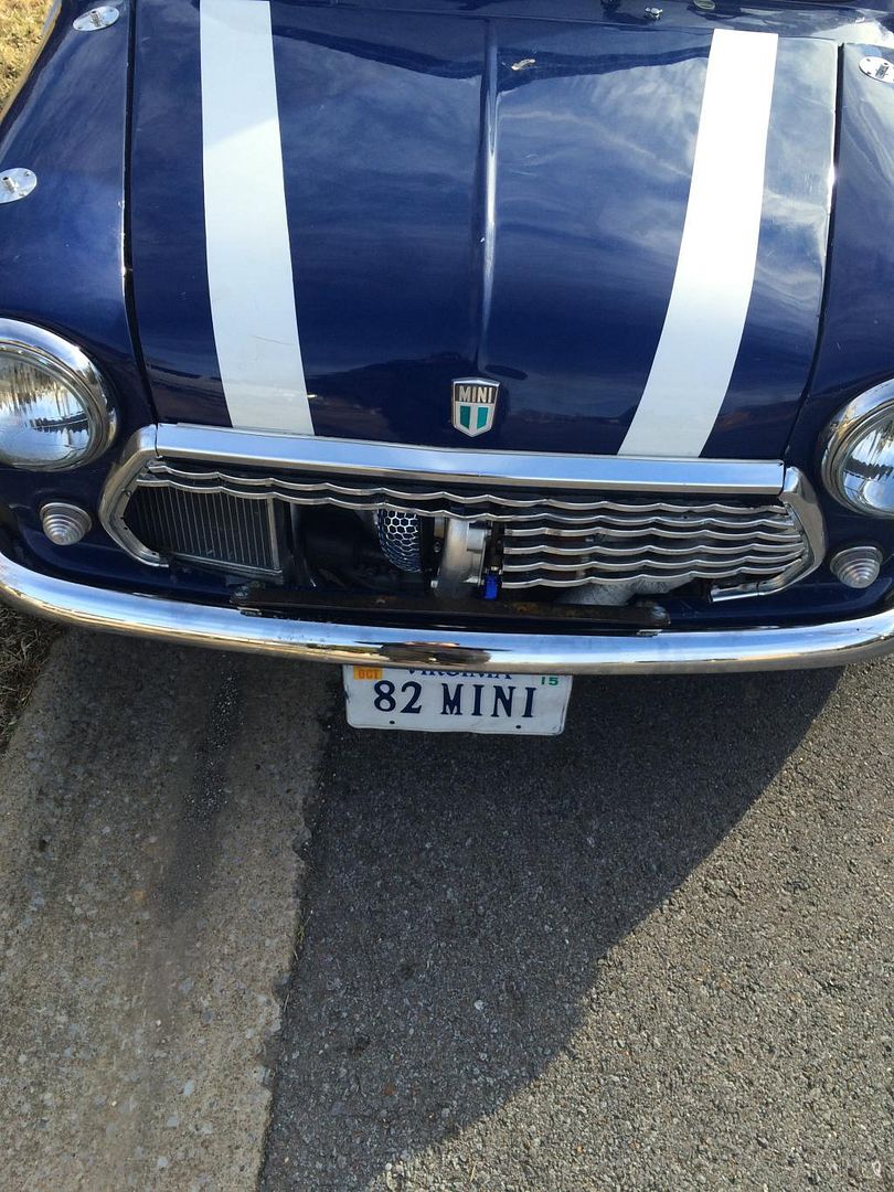

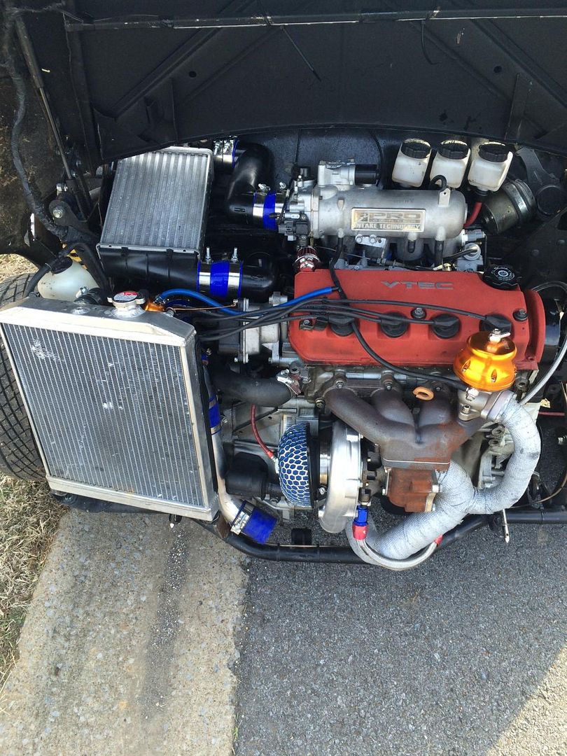

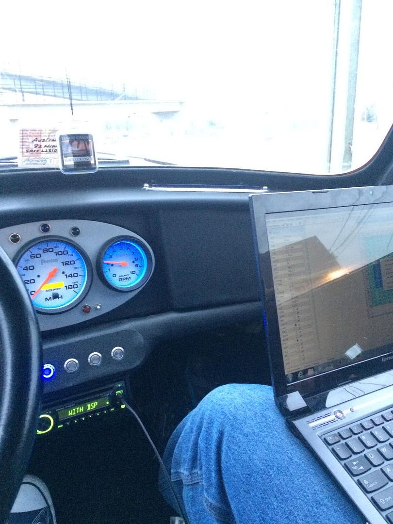

  • ok ok, so turbos.. are awesome, it is way wicked now and I see why some of you with the higher horse power engines talk about torque steer issues, I really didn't experience it much at all with just the stock D but now if the turbo and vtec kick in I get some torque steer but its manage able, so its been road tuned and pulls great full throttle 0-60 its a rush but with the larger turbo it is great for daily driving too cause if I don't get on it it really never kicks in to hard. good lord is it fast, lovin it and got it to fit better with a different air filter so now I need a grill to replace the hacked up one I got.
    • oh and the pvc held fine for 4 hours of 2k-7k full pedal pulls up and down the road no issues.

        What is the horsepower with the turbo? Did driveability suffer at all with the turbo? How much faster is it and do you have increased temperatures of the engine because of the heat created by the turbo under the hood? I know I am asking a lot of questions, but I have a D15B powered mini also and am very interested in your opinion. Thank you.

          I myself have a turbo d16 as well and made my manifold etc.Placed it on with the stock injectors @4psi at first with a hondata s300 and it does not lean out at all.Driveability is stock like for me just a bit of a handfull in boost but im slowly sorting that out and now am creeping up with boost and installing larger injectors etc.

                Space..its a big issue with a standard round nose to get it to fit without modifying the body ,grill,etc.I managed to fit it even with an MK1 grill and didnt cut anything at all.
                Cost and maintenence...it can be done fairly cheap but everything adds up.Maintenece on a turbo car,depending on if you know about them or not they will cause issues and sometimes are finicky and require a lot of maintenece until everything is right.Clutch ? Do you have a good clutch? Depending on boost levels the new power willput stress on that and even the motor depending.
