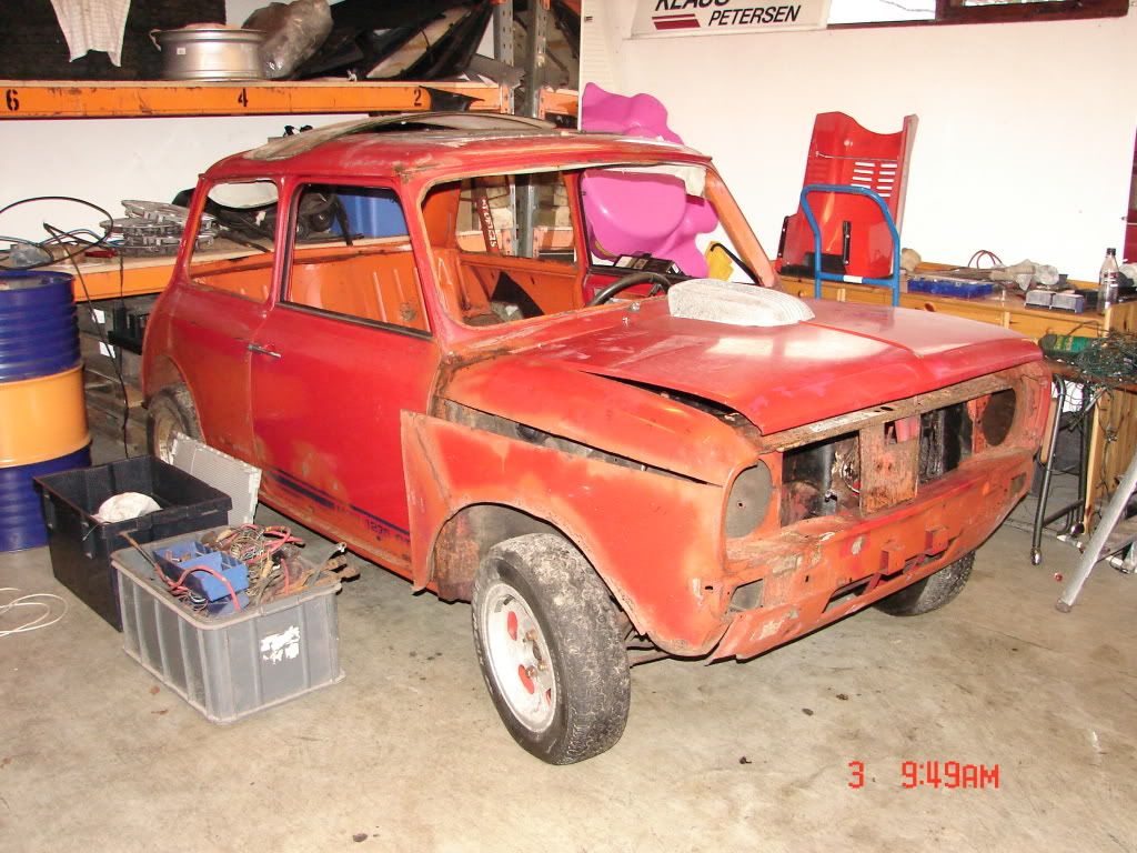

    When I bought the clubman 2 years ago
    The car stood for almost a year before I started the restoration, because of a new job and house.
    But here are a few picture of the body work, that was needed before I could start on the funny stuff (B16a)
